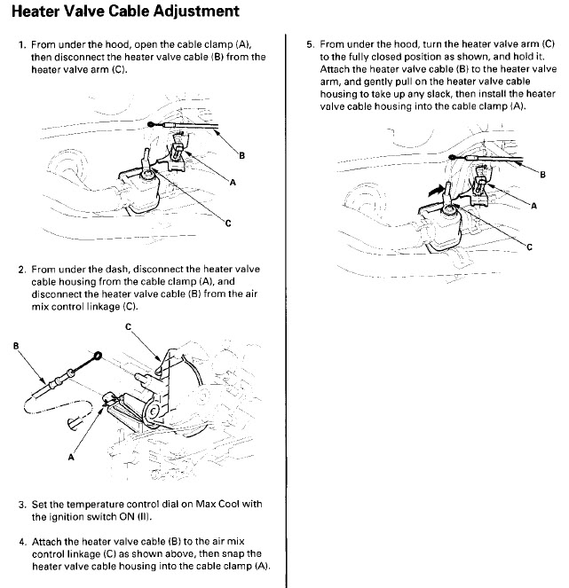

Did you happen to disconnect the heater valve cable under the dash?

Yes but plug it all back in
Old Nov 17, 2008 | 08:05 AM
Check whether or not the heater valve on the firewall under the hood properly opens and closes when the heater lever is operated.
Also check whether the coolant level in the radiator and reservoir is full. If all seem fine, then another possibility is that the thermostat is stuck closed.
