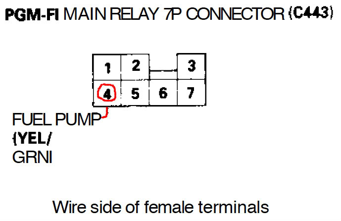

Pull the diagram (place that RonJ uses) and identify the wire from the main relay to the fuel pump. Cut that wire and splice the switch to the ends so it opens the circuit when you turn it off. Actually there are a lot of wires you could cut to (temporarily) kill the car, for example put another switch in the ignition circuit.
Old Jul 3, 2008 | 01:38 PM
Default RE: kill switch HELP
ORIGINAL: mk378
...identify the wire from the main relay to the fuel pump...
The picture shows the connector for the main relay located behind and to the right of the glove box. Terminal 4 of this connector leads to the YEL/GRN wire that runs to the fuel pump.
