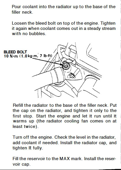

Also try bleeding the cooling system, which may take 20-30 minutes:
1) Park the car on an inclined driveway with the front end higher than the rear.
2) Push the dash heater lever/**** to MAX heat.
3) Follow the directions in the diagram below (hint: the bleed bolt is located where the upper radiator hose connects to the engine):
