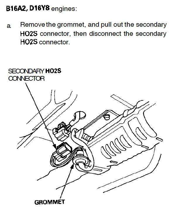

The secondary O2 wire for my stock 00 D16Y8 feeds into a rubber plug in the chassis below the front passenger seat (I think).

By looking at your diagram it looks like the secondary one is located on the actual cat itself. The one we saw is on the pipe leading up to the cat. Ill check again tomorrow, maybe we just can't see the secondary because it's about 2 in the morning and we're just using a lamp. It doesn't help either that the jack we're using right now isn't that high and my cars lowered too! Ill let you know tomorrow how it goes. Hopefully it doesn't rain so I can check it out!
