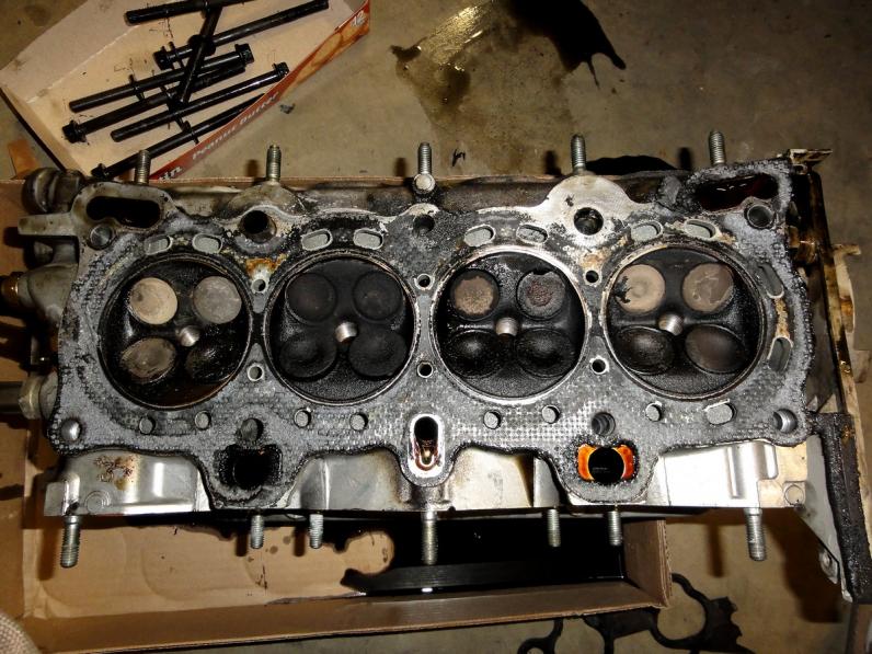

Well all my tests indicated a bad head gasket, but it turned out being a cracked exhaust valve. There is a tremendous amount of build up on the combustion chamber side of the valve, and no doubt the valves seals were leaking quite badly.
I cleaned the top of the piston to see if there was any damage from the valve fragment, but as best I can tell it appears to have been ejected. There is no damage to the cylinder wall either.
I am trying to decide if I should rebuild this, or just buy a remanufactured head, can get one for $175 ready to go.
