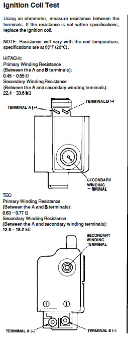

If there's no spark, remove the coil and ICM from inside the distributor. Resistance test the coil and have the ICM tested at an auto parts store. Also look for any damage inside the distributor during the process.

if your coil/igniter is bad replace both at the same time. i just had my igniter die and the new igniter, i guess operating where it should finally, killed my coil within 2 hours. Plus, they are $100 each at autozone, but if you buy a whole new distributor, its only $140 with a returned core. great deal if ya ask me. if you need help testing/installing any of this pm or post here
