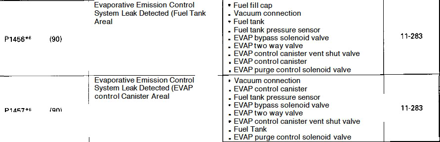

Code 90 indicates a problem with the EVAP emissions system. You might be able to get more information about the problem by pulling the code with a scan tool at AutoZone. Start by checking the gas cap rubber seal for damage and for leaking vacuum lines under the hood.

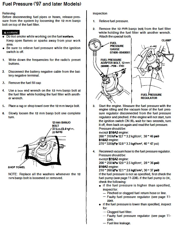

Based on what you have done thus far, I would recommend that you next measure the fuel pressure with and without the vacuum hose of the fuel pressure regulator connected, if this has not yet been done. Since replacing the ignition system components, have you checked whether any of the new plugs looks fouled? Were the plugs properly gapped?

Cool, thanks RonJ, you are awesome. Out of curiousity, would you say that $40 is a sound investment for a fuel pressure gauge? Doesn't look like they can be rented / borrowed from any of the local stores here in Oregon (Autozone usually loans that type of thing).
Not sure -- I haven't priced fuel pressure gauges. I have a Harbor Freight Tool store in my neighborhood that generally has very good prices. If you have one in your area of Oregon, have a look. You will also need a special adapter that allows you to connect the gauge to the Honda fuel filter.
