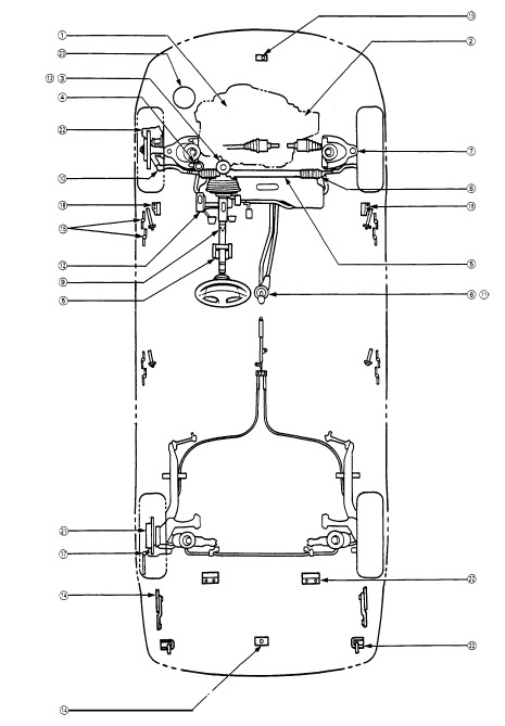

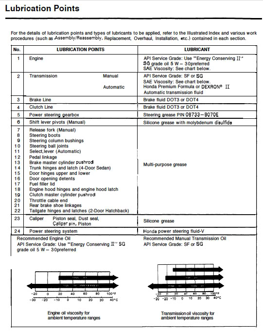

Does anyone know what all of the lubrication points are for a '95 Civic DX (D15B7 engine)? I'm assuming that this car has some, but I do no see them referenced in my Hayne's manual. Thanks,
Andy
Old Jun 6, 2008 | 12:01 PM
Default RE: lube points for '95 DX

Thank you Ron, I appreciate it as always.
I'm wondering if there are any points that it is good to keep after on a regular basis. It's been my understanding that some makes and models have points that a good garage will tend to when an oil change is done. Are there any of these on the older Civics?
Andy

If your meaning grease zerks were the use a grease gun you dont have any.
