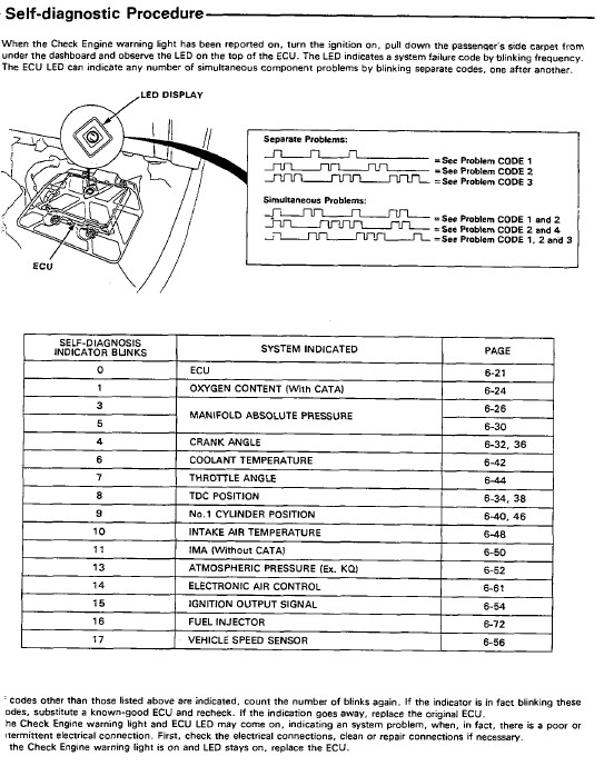

Here's how to determine whether the ECU is throwing a fault code:

I DID THE JUMPING OF THAT CONNECTOR AND CEL DOES NOT DO ANYTHING.
AND THE ECU DOES NOT BLINK EITHER
Old Jun 7, 2008 | 09:16 AM
Default RE: SPUTTERING
For a 91 Civic, there's no need to jump a connector to retrieve the ECU code just turn ignition key to ON and read the LED light (see diagram).
Old Jun 7, 2008 | 09:21 AM
DILLIGAF919's Avatar
Joined: Jun 2008
Posts: 21
I DONE THAT FIRST AND NOTHING.
Old Jun 7, 2008 | 09:24 AM
Is the ECU LED ON or OFF?
