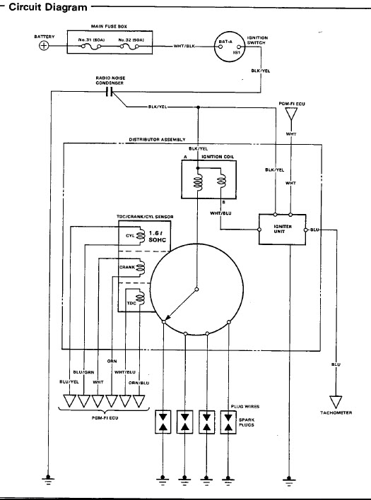

The first picture below shows how to test the coil using a multimeter.
Next, use the circuit diagram to compare wiring of the stock distributor to that of your distributor. Also check whether you have battery voltage at the BLK/YEL wire when the ignition key is turned to ON.

well, i went through the crx manual and found the distributor circuit diagram, and i looked at the del sol distributor diagram, and this is what i found.
del sol diagram:
crx diagram:
after looking at the 2, i noticed that the conversion that boomslang (or whatever it's called) has it wrong. the colors are the same but what they connect to are different.
so this is what it's supposed to be:
so this is the diagram i came up with. the colors are the same, but they don't CONNECT to the same sensors! i'm gonna check if this is right tonight when i get home from work, but i believe this will solve my problem. hopefully [sm=smiley20.gif]

Good luck. My concern is that switching the white wires may have damaged something in the distributor, like the coil, igniter, or one of the sensors. I hope that I'm wrong on this account.

well, i was messing around with the crx again last night. i swapped out the spark plugs with iridium tipped plugs i had from my old head. i re-pinned the distributor connector to how it's supposed to be, and now i'm getting a good spark. the car almost sounds like it's about to start but won't. so i went and rechecked the timing. it looks like the timing belt is off by about ½ of a tooth. i don't know if that might be the problem or not. i can't seem to find a clear answer on this. i have the stock d16a6 block, and i'm using the timing belt for the d16z6 head. it's really a pain in the *** to put on, but i can manage to get it on there. so the vx timing belt is out of the question. it has 103 teeth i believe. the z6 has 104 (which i'm using). and the b7 has 107. i looked at the stock a6 timing belt and it looks like it's off by the same amount. does anyone know what timing belt would fix it? i really don't want to have to by an adjustable cam gear. or if anyone did the swap, can you send me in a picture where the timing for the cam gear is supposed to be. right now it's where it looks like it's supposed to be for the stock z6 engine. but maybe i'm a little off.
but i have spark now. so the dizzy and the ignition coil and sensors are still good. if the sensors were bad, it wouldn't get any spark. hence why i didn't get it before. this swap is just turning out to be a pain in the ***! i'm about ready to say screw it and go back to the original head lol.
