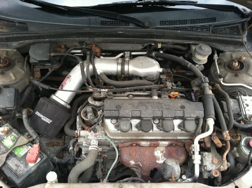

What kind of Engine is this? 1.7L 4Cyl?

replace your AC belt and alternator belt, they're probably due for replacement anyways. only about $20 a belt ish?
that is the D17. not sure if it's the vtec edition or not.

Can't really see too well in the picture, but it says VTEC underneath the Honda on the engine. Is it the D17A2? Does that affect the belts I need?

Since it's an EX the D17A2 is the stock engine. Other than the intake, everything under the hood looks to be stock. Belts should be the same as the DX and LX but if there's any doubt tell the parts store it's a 1.7 liter VTEC.
