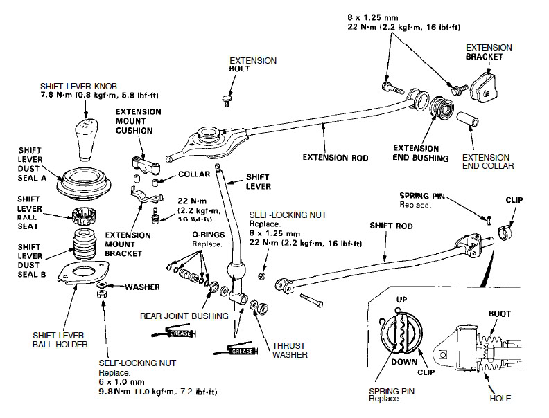

Ok so my shifter in my car was wacked one day I noticed that I could put it in gear and still move the stick around and it wouldn't come out of gear then tonight I was driving went to shift and it was like I had no gears I could just move the stick around and not touch any gear what do you think the problem is .......I assumhed its a linkage what do u think
Old Jan 8, 2011 | 05:26 AM
Check the shift linkage under the car.
Old Jan 8, 2011 | 06:01 AM
mk378's Avatar
Posts: 10,023
The ball seat tends to wear out / fall apart. If that's the case you may be able to shift by pulling upward on the shift lever while moving it.
Old Jan 9, 2011 | 12:43 AM
civicster2000's Avatar
Joined: Jan 2011
Posts: 3
Well tonight I had taken apart my middle console. And see it was my shift rod the bolt is gone so I hope that's all I will have to replace
Old Jan 9, 2011 | 12:44 AM
Joined: Jan 2011
Posts: 3
But this diagram. Did help identify. Parts thanks alot
