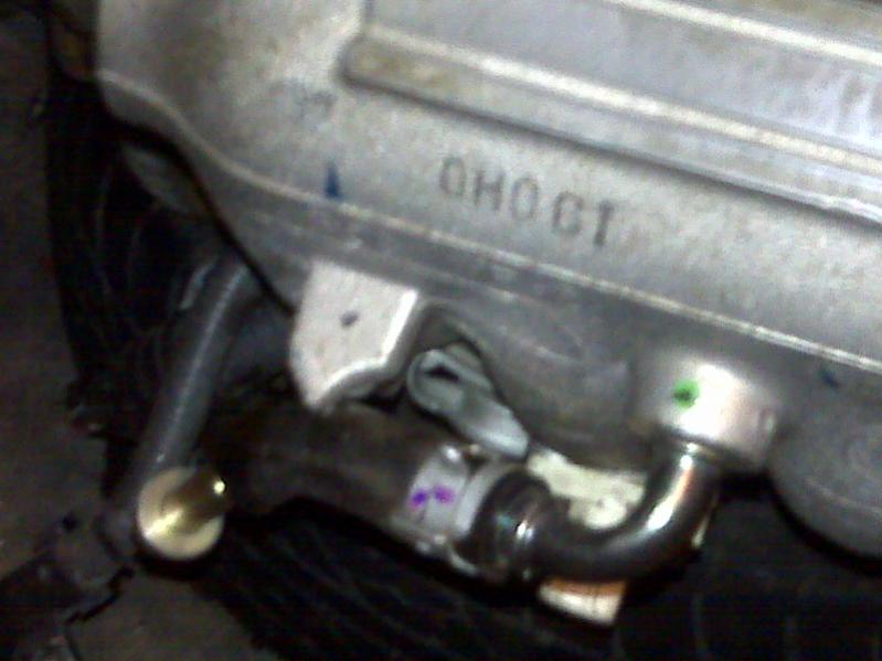

Okay i got a swap going on with a JDM engine . I got it all configured and all sensor ready except one . On my old intake its has a 6345 014 1 FILTER ASSY., SOLENOID VALVE , and a VALVE ASSY., PURGE CUT SOLENOID see pics . The new swap does not have one on intake but has much better intake and throttle body. (yes i got the correct tps sensor working and funtioning in the jdm thottle body . ) Here the problem. I need to trick out the one sensor . see pics and any ideas appreciated . 1st oict oarts diagrams and it number 16. second pic old intake and third is new jdm motor intake but does not have hose hook up to intake.

Put a tee in the line that goes to the brake booster or maybe the fuel pressure regulator and connect it to the bottom port of the valve. It's all just manifold vacuum.

Cool thanks . Now it all complete .nothing swapped off the old motor.beside that and tps .
