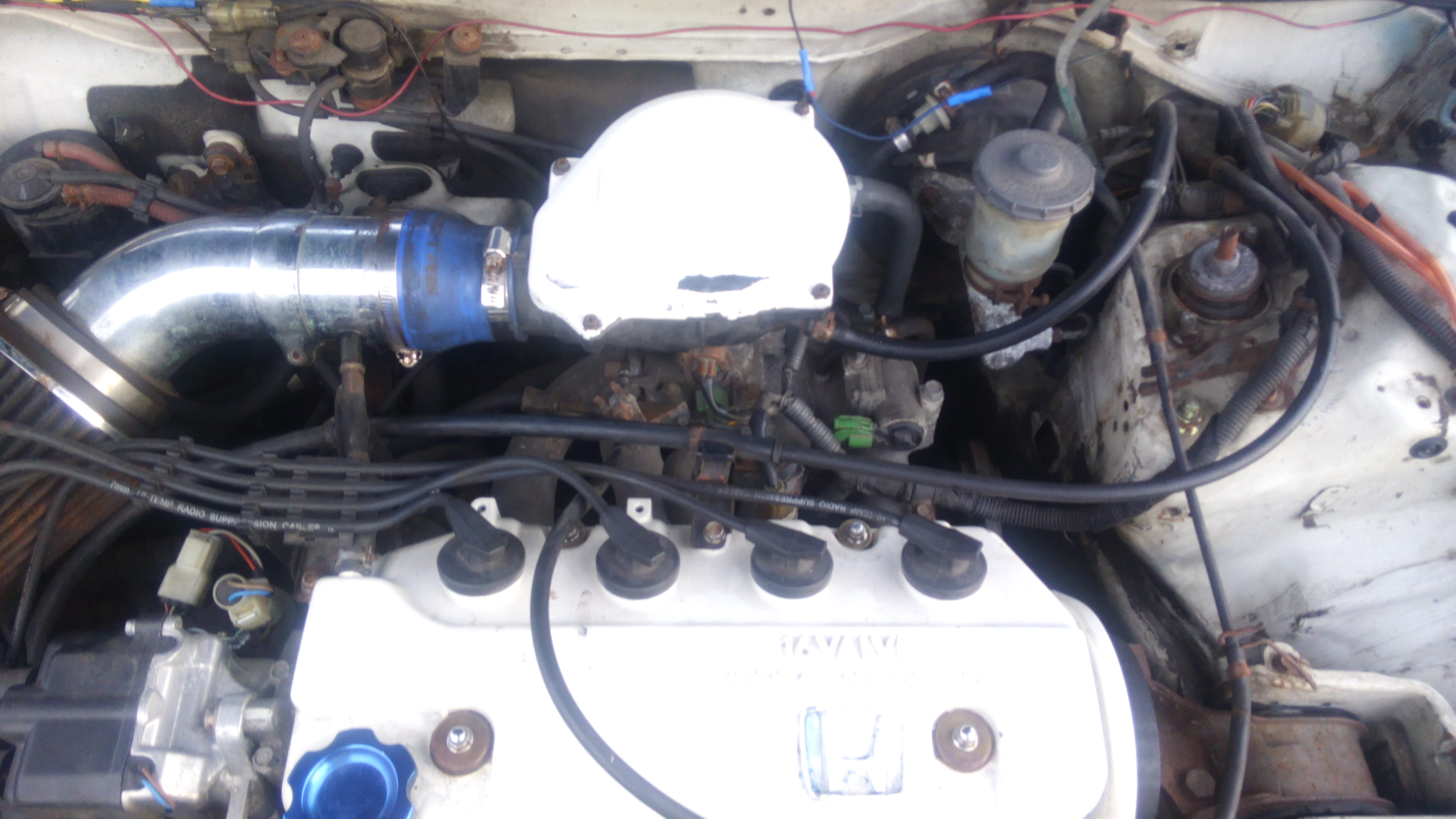

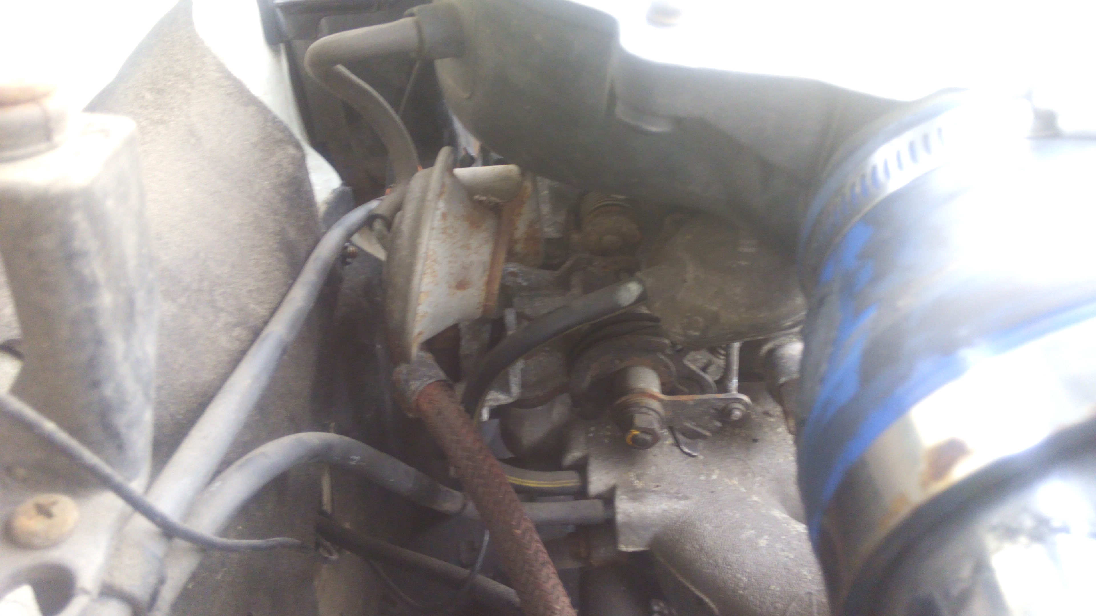

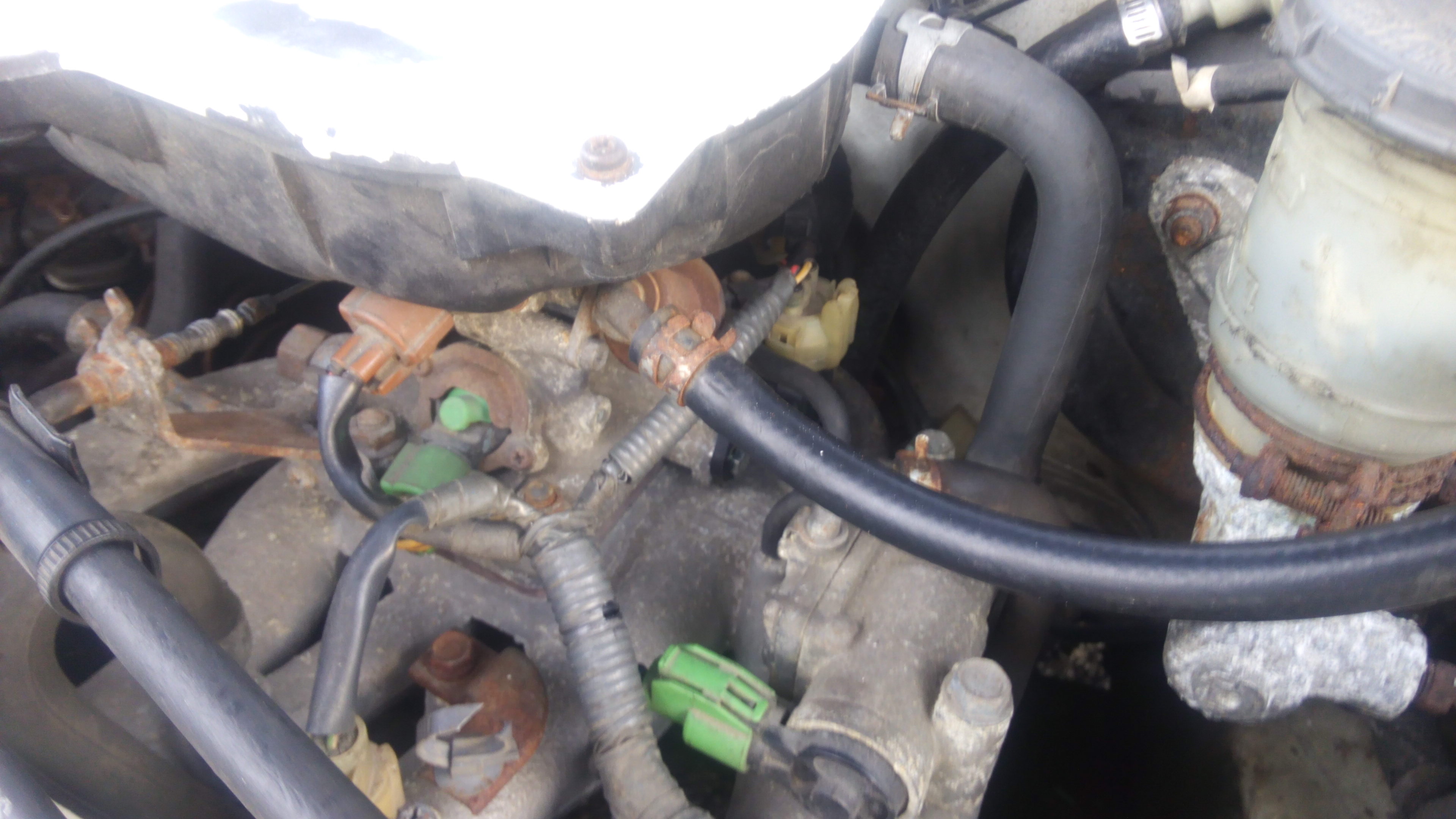

Since I don't know where anything is in the car and nobody is stepping in..... I have a throttle cable i dont see a throttle body. I dont see an egr valve anywhere nor anything other than the TPS and thats it
Old Sep 23, 2015 | 03:25 PM
XxDigitxX's Avatar
Joined: Sep 2015
Posts: 31
From: Oshkosh WI
Default Engine areas.
I am out of ideas
Attached Thumbnails Need Some Advice ASAP-img_20150923_182231.jpg   Need Some Advice ASAP-img_20150923_182243.jpg   Need Some Advice ASAP-img_20150923_182219.jpg
