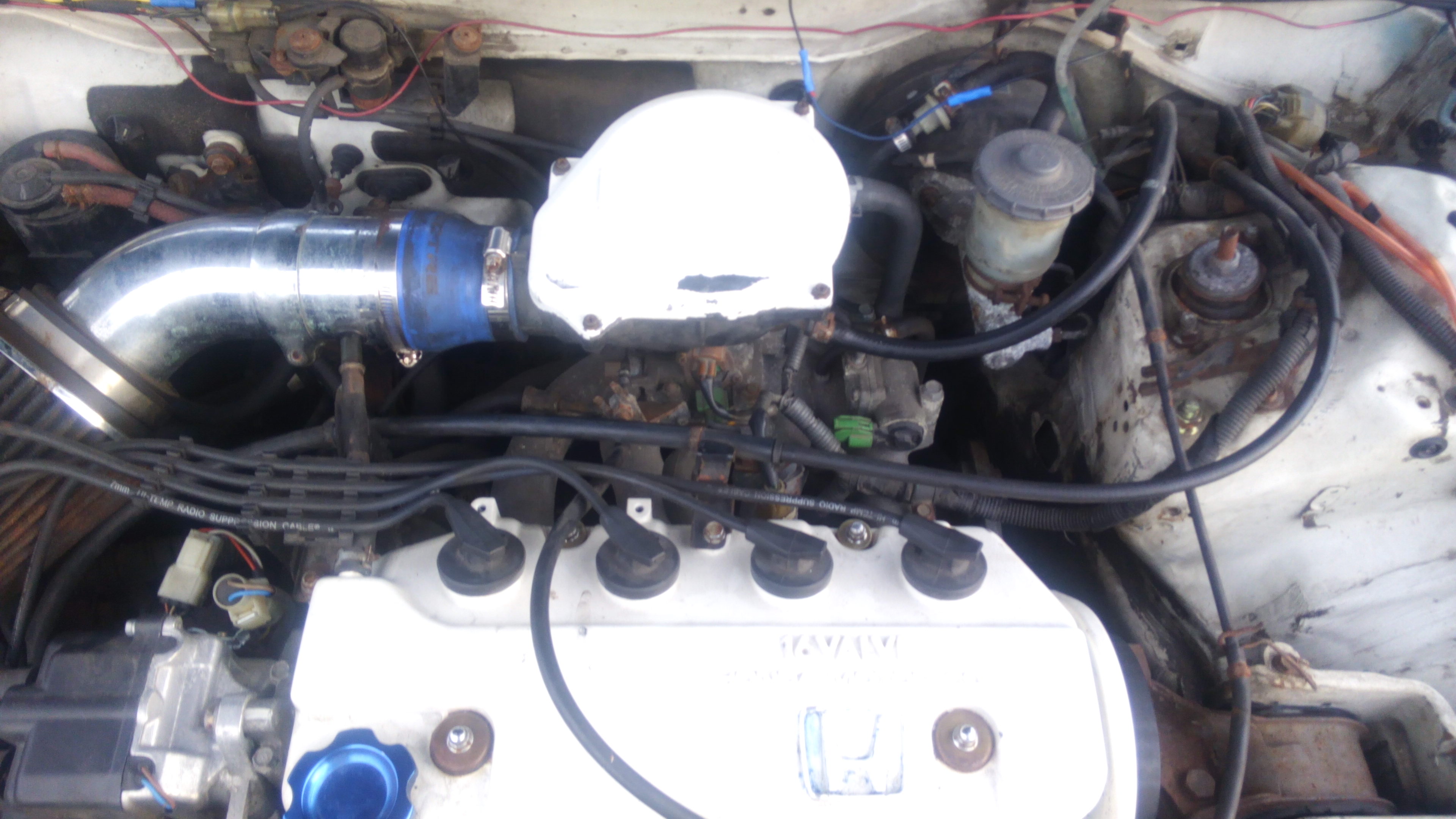

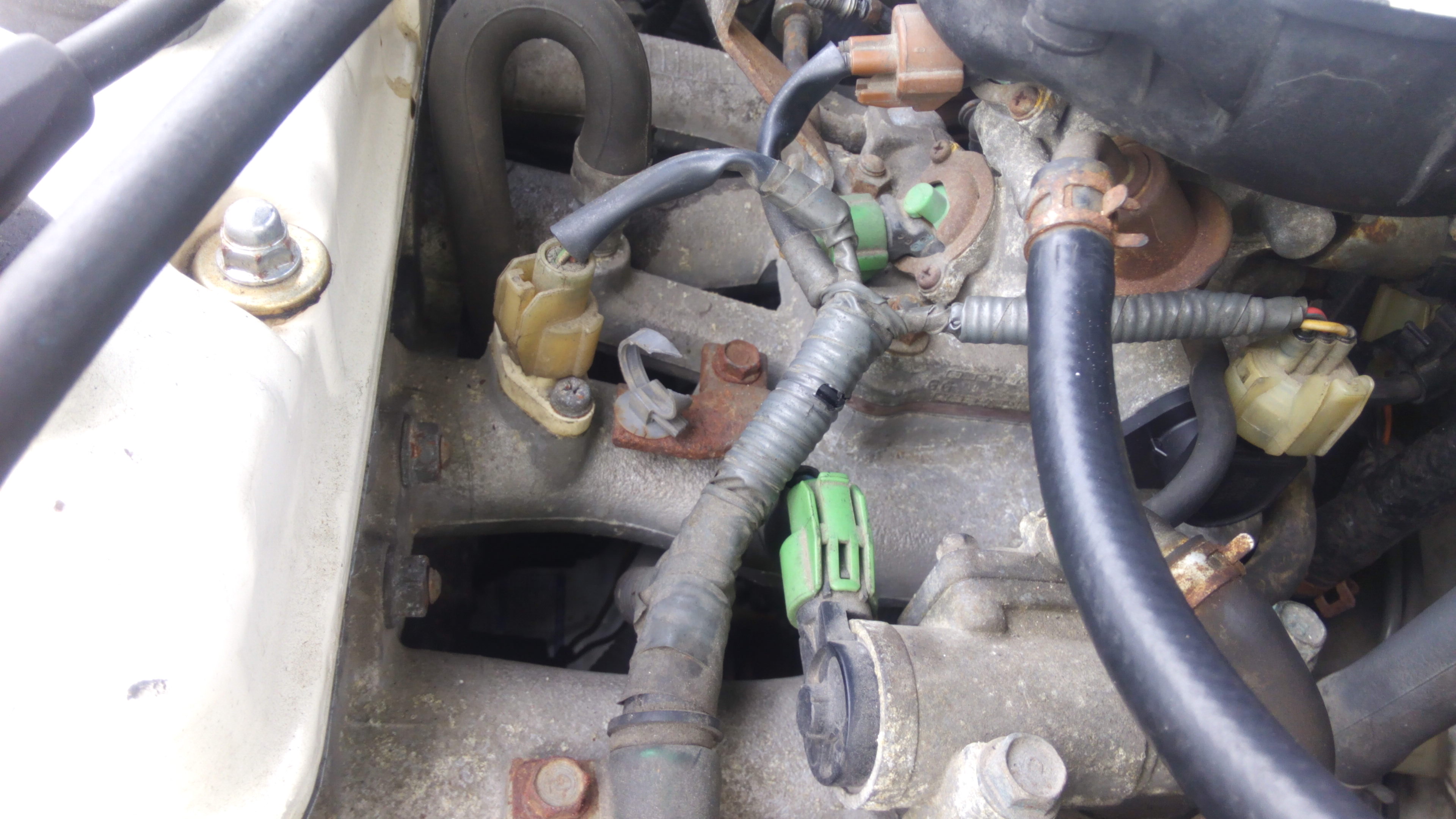

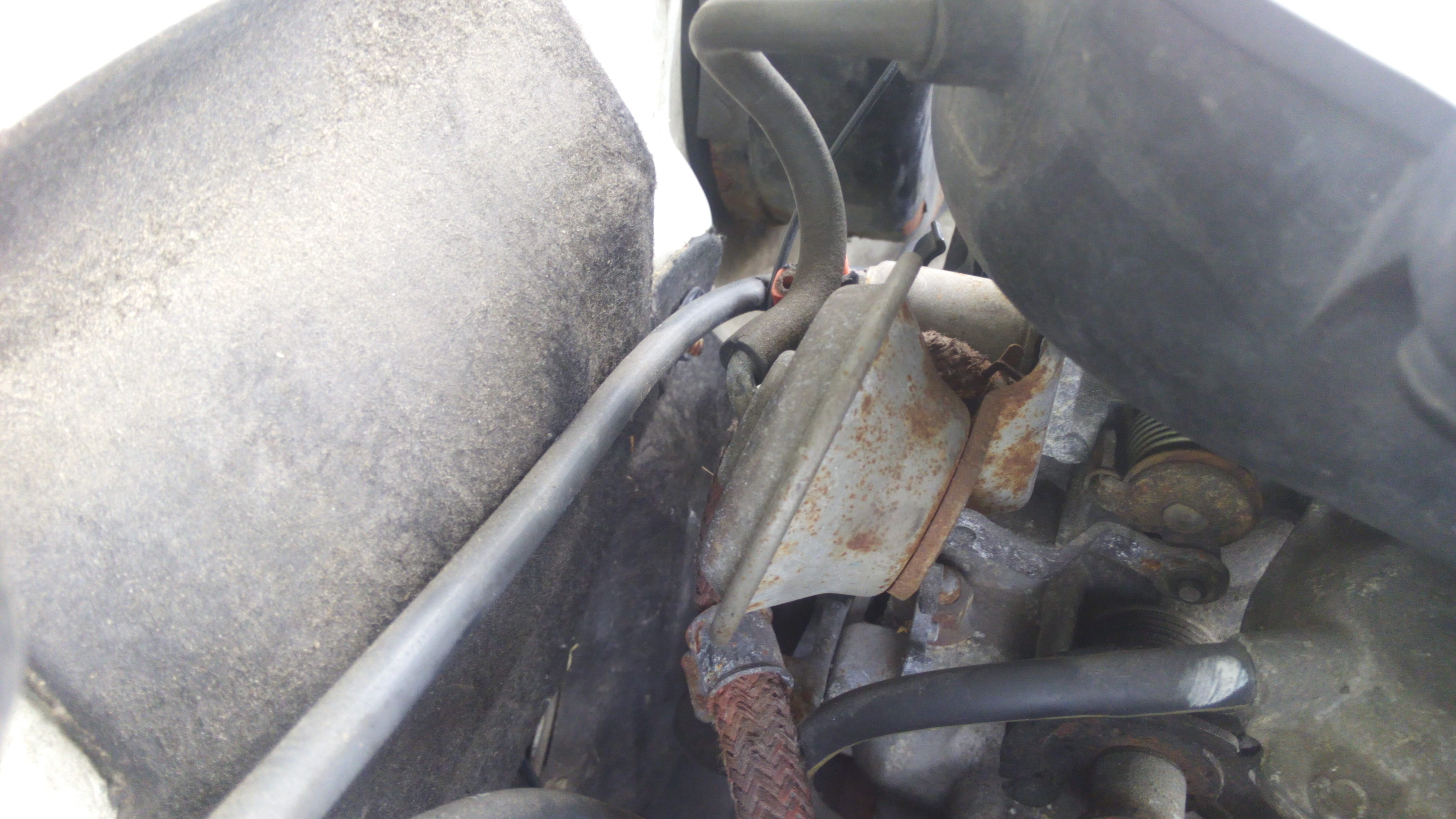

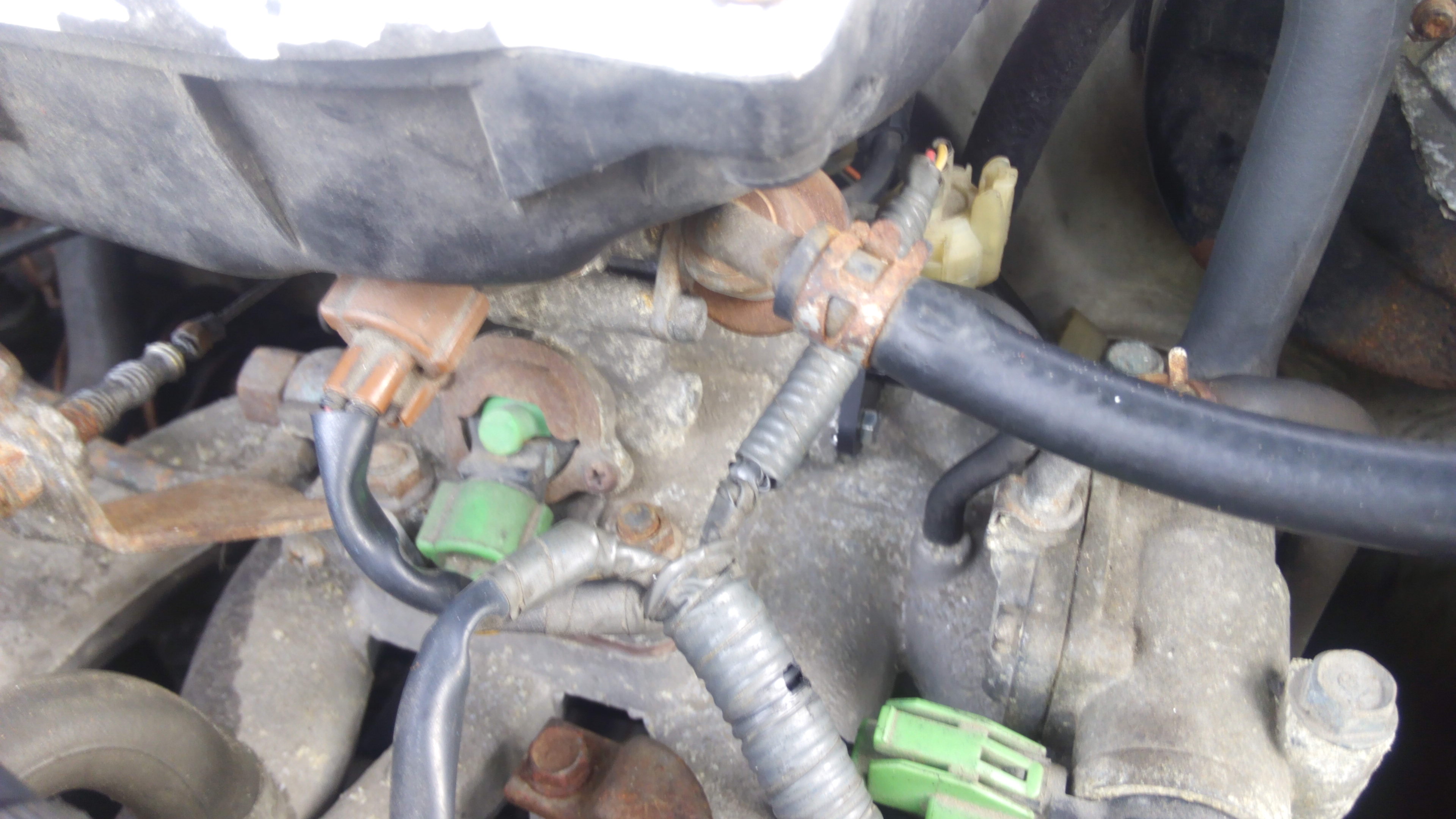

D15B2 engine top view and side views of sensors.

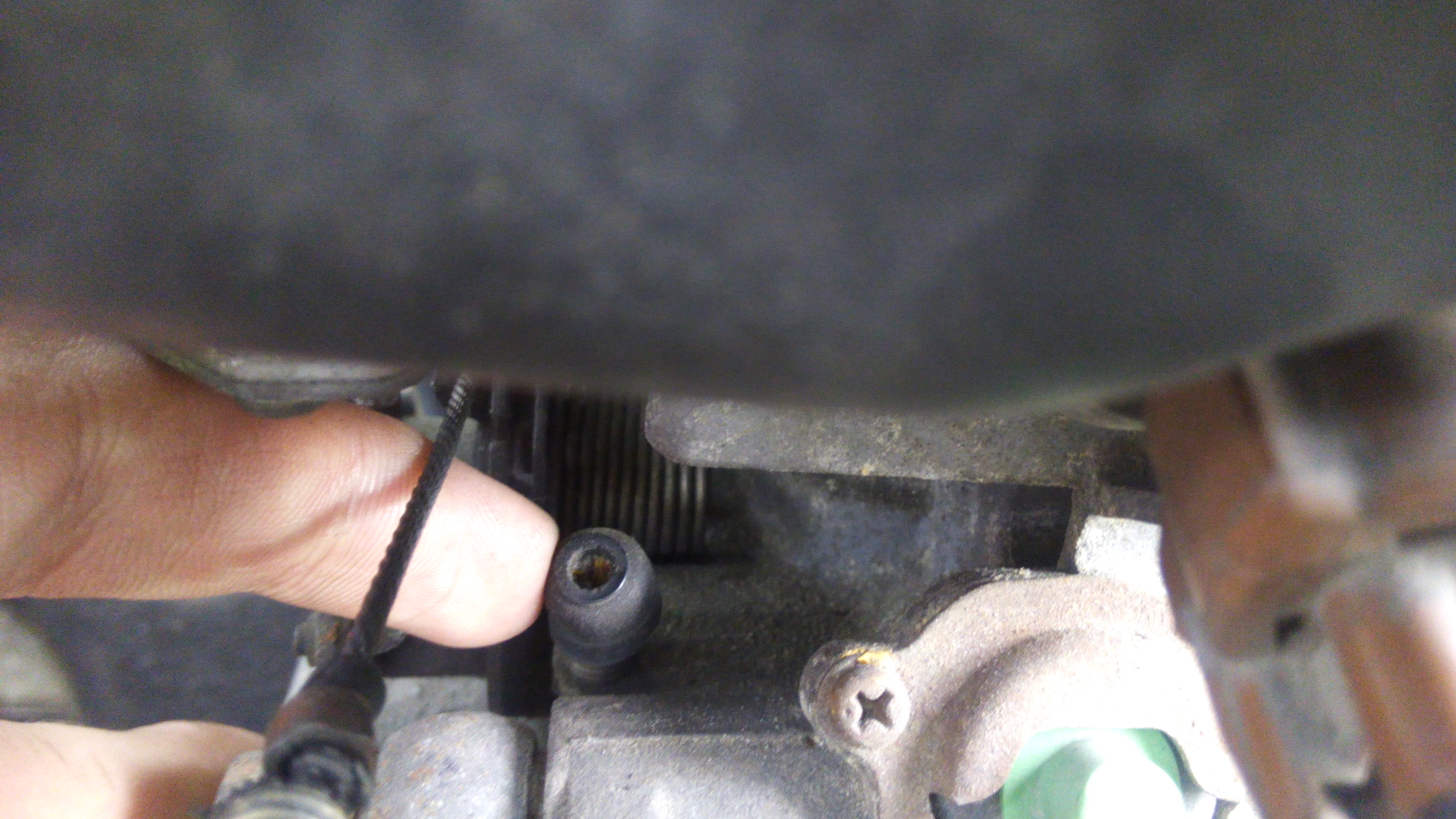

Idle thingy?

All because of a sticky throttle cable!!! Found out the culprit!
