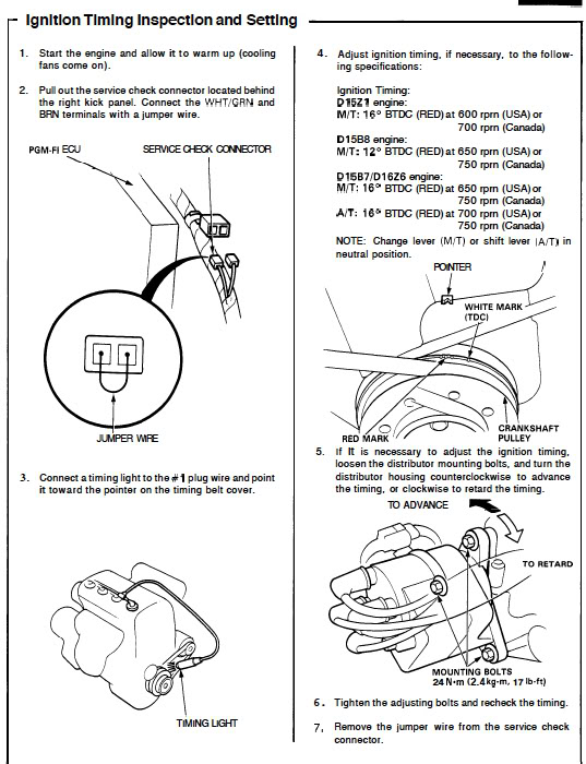

You might want to check whether the ignition timing is set to spec:
