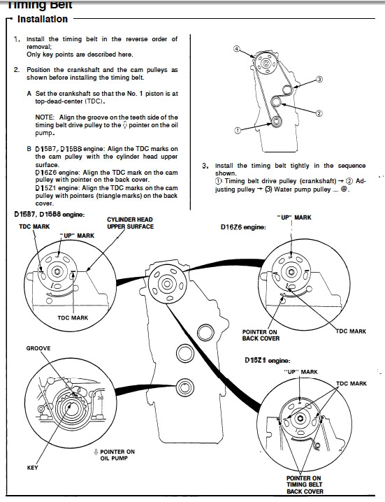

Sounds like the timing is still off a bit. If you are having problems setting the ignition timing to spec, you might want to check whether the camshaft gear and crankshaft pulley are slightly out of sync at TDC (= timing belt slipped a tooth). To do this, you must remove the valve cover and upper timing belt cover.

Can the timing belt become lose, causing it to lose timing and not want to run, like it is currently doing?
Old Apr 14, 2008 | 05:06 AM
  #28
Default RE: New honda owner, few questions
Yes

Not sure what you mean when you say "when the timing is set the way it was when I got the car". If the engine runs more smoothly when the ignition timing is not set to spec, then the timing belt is likely off by a tooth.
