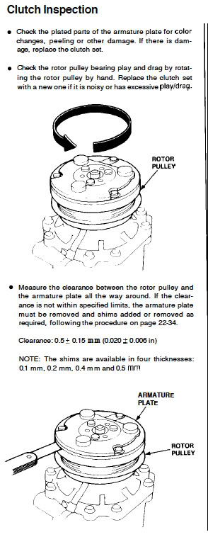

Your compressor clutch may be failing. Check this:
