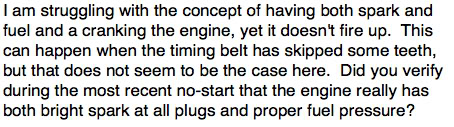

Old Jul 16, 2008 | 02:01 PM
Default RE: Not starting problem
yes put brand new plugs in and fuel was good. i think it might be a bad fuel regulator but this is a very wierd problem and very hard to diagnose since it is intermintent. and once it starts running when i jump start it or pop start it it runs fine and can drive for as long as it can go but sometimes if i stop it wont start again other times it will its very interminent very peculer
