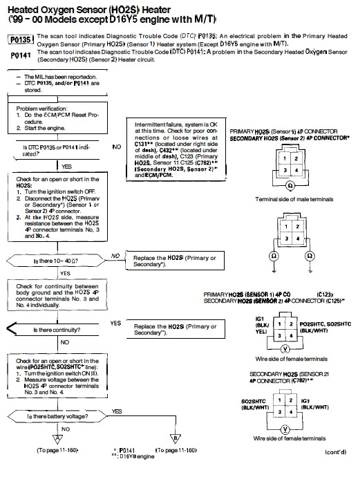

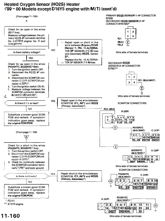

Yes, the CEL code is for the heater element of the primary O2 sensor (located before the cat). Be aware that the problem could be with the sensor, the wiring, or the ECU.
You will know whether the sensor itself is bad by doing the electrical troubleshooting on the first diagram below:

It failed the first test. NO nothing on any post. So I am going to replace with a universal.
I can get one close to home for $58. Online for $35something. Don't know if I want to wait for it tho.... Will the universal do any damage?
Old Apr 28, 2009 | 04:30 PM
Nice. You can now be confident that a bad sensor is problem.
