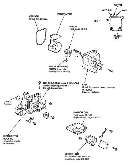

Well was cleaning up the engine compartment. After I was finished I went to start it and it ran fine. But as soon as i backed it up it started missing. Unplugged number 3 and that was the one. Took apart the dist cap and parts fell out. Seems the phillips screw holding the rotor on fell out. It broke the plastic cover that is just behind the rotor. Would it be a problem to remove this completely? Also what would be a nice upgrade over a stock distributor?
Old Apr 12, 2009 | 02:01 PM
Replace the rotor, cap, and inner cover. Do not run without the inner cover unless you want sparks flying all over insider the distributor (=distributor death).
