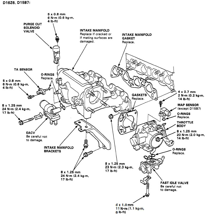

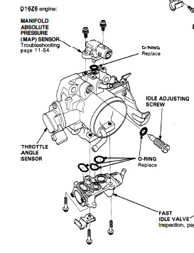

The FITV is shown in the diagram below. Click FITV in my signature. In contrast, the IACV is on the rear of the IM.
EACV = IACV

Ok. I'll try again to figure out whether it has one or not when I get home. Those pictures should do the job.

Looks like Ron's got you on the right track.
TPS is the Throttle Position Sensor and is a black plug on the rear of the TB.
EDIT: Looks like it's referred to as a Throttle Angle Sensor in the image above.
