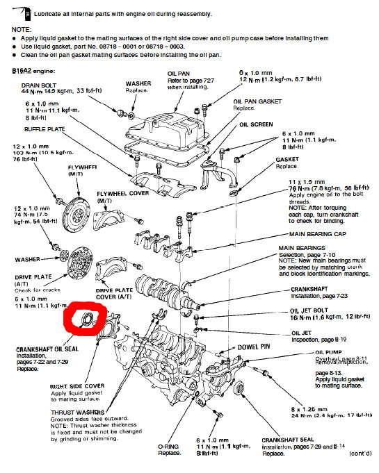

this is gonna sound stupid but where is the rear main seal located and what do i have to take off to get to it?
Old Jun 10, 2008 | 08:25 PM
Default RE: oil consumption
The seal is circled in red. I believe you need to remove the transmission and the flywheel to access.

ok good. i was actually planning on doing a clutch and flywheel upgrade anyways so this happened at the right time. is there oil getting into my transmission and will it cause it to mess up or go bad? this info is much appreciated! this forum rocks!
Old Jun 11, 2008 | 04:56 AM
Oil is leaking from behind the flywheel and should be draining out of the weep hole of bell housing. The leak will not affect the transmission but could potentially splatter on the clutch, although I don't think this is a real concern.
