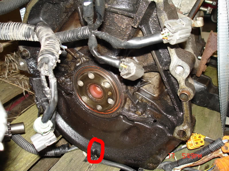

where is the weep hole on the bell housing and what exactly is the bell housing? the cover to the transmission?
Old Jun 13, 2008 | 05:51 AM
Default RE: oil consumption
i believe its just the flywheel cover if im not mistaken.
Old Jun 13, 2008 | 05:57 AM
Oil weep hole circled in red in addiction's nice photo:
