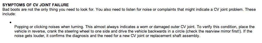

Old Sep 3, 2008 | 08:02 AM
Originally Posted by jbum
bad axles generally make a repetitive clunking/knocking noise. not just a single pop.
Though verification is clearly needed, the type of noise heard by michael_bolton will generally indicate a bad CV joint (see text and link below).

Old Sep 3, 2008 | 12:48 PM
jbum's Avatar
Joined: Sep 2005
Posts: 188
From: SF Bay Area
true, if the popping noises are continuous while turning. i understood it as a single pop... but it's not clear from the original post.
