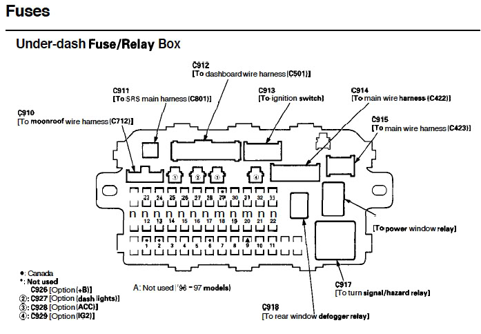

You know that there are 2 fuse boxes, which is more than a lot of people do. Fuse #15 is in the box under the dash.

i see okay then i will check it today and put some electrical tape on my exposed wires
