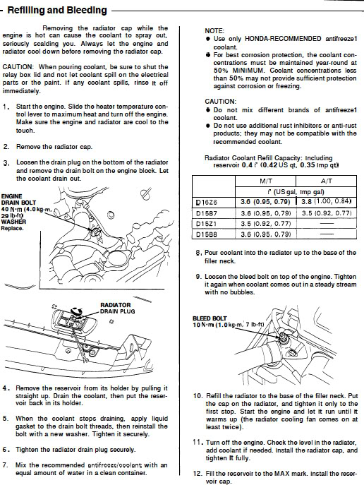

Does the radiator fan turn ON when the engine is hot? If so, you probably just have some air still trapped in the cooling system. The remedy is to bleed the system. Start at step 8 in the picture:

By the way, the radiator fan should only turn ON when the engine is hot. If it doesn't, then check whether fuse 13 or 33 is blown.
If the fuses are fine, then you may have a bad coolant temperature switch (on thermostat housing), a bad fan relay (under-hood fuse/relay box), or a disconnected ground wire for the fan motor or temperature switch.
Regardless of the fan problem, you should also bleed the cooling system. This should solve the idle problem, and also possibly the overheating problem.
