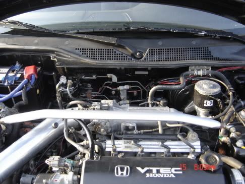

I have a stock 93 Honda civic.
Im putting ram air intake on it where does the small hose
coming out of the ram air tube connect too.
Thanks

well if thiers a small hose then its probably for the valve cover or to some vacume device.....
check your factory air intake for a tube........

the normal intake sits right above the engine.. I just put mine in but ya the lil tube in prob vacum just so its just one persons voice...... also addiction love the car man how long have you had her...

is the whole close to the engine?
It's kind of hard to see in this picture (stupid strut tower brace [:@]lol), but see the silicone tube at the top-left of the valve cover? that's where it goes. Or, you can stick a crank case breather on the valve cover and stick a bolt or something in the hole on the intake tube. I did that last week (my camera's busted, or I'd have pics)... it looks a lot cleaner.
