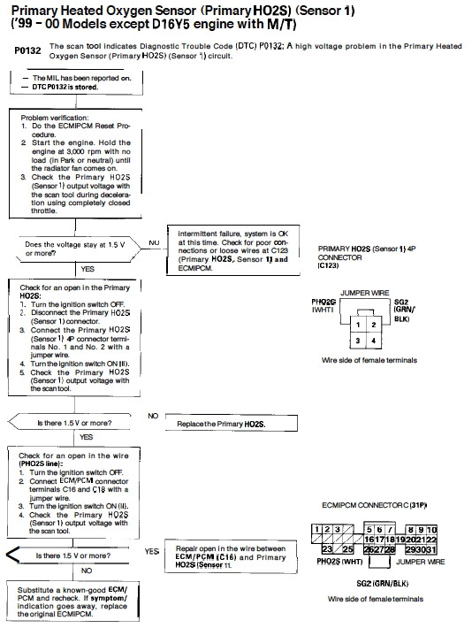

What type of replacement O2 sensor did you install?
Other potential causes are a bad wire between the O2 sensor and ECU or a bad ECU:

I used a Denso sensor and it was the primary. I also installed new plugs, wires, distributor cap & rotor. According to the scan tool, at idle Sensor 1 is reading 1.275 and 2 is 0.015 volts.
Thanks for all the help. I trying to figure out the problem instead of just swapping parts.
