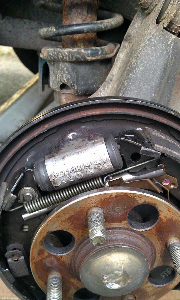

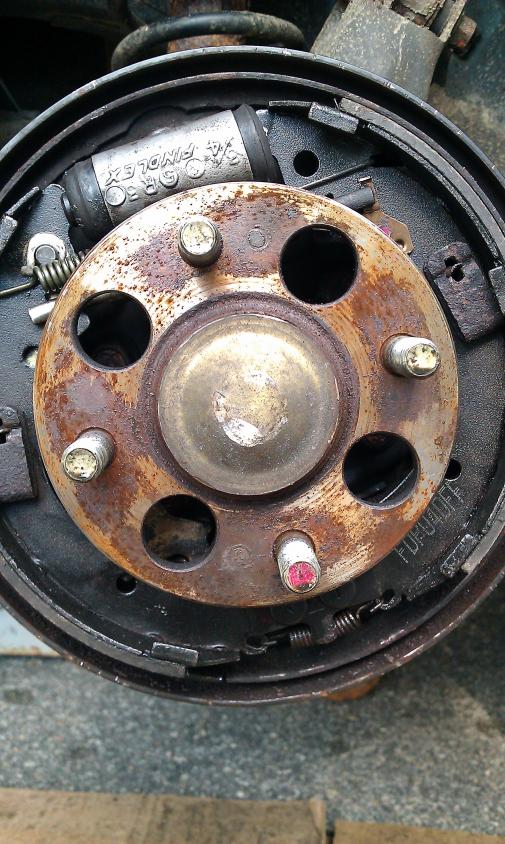

Just took both drums/brake assemblies off, and re-did them (I had a friend's '97 Civic at the house to compare to this time) - On the driver's side, my adjustments are perfect, and it was an easy process ... The passenger's side, however, is being a major PITA - I have the adjustment bar all the way closed, and still had to struggle to get the drum back on (The driver's side is adjusted out about 3mm for a little less than one turn of the wheel before it 'sticks') - Compared to my friend's Civic, everything looks exactly the same, but HIS rear brakes work, and mine STILL do not! Once I put the rims back on, and did a short test run, there is no affect at all when I pull my e-brake. I still have my front brakes working, so I can still drive the car, but I'd feel a hell of a lot better with all FOUR brakes working! Any suggestions at all? I've spent the past two hours Googling this, and couldn't find anything even CLOSE to my problem o_O
Edit: This is the side that doesn't seem to want to cooperate o_O
Attached Thumbnails Rear Drum Nightmare!-imag1771.jpg   Rear Drum Nightmare!-imag1772.jpg
Old Aug 22, 2012 | 02:55 PM
droopy128's Avatar
Joined: Jan 2007
Posts: 631
From: Bayarea, CA
did you reconnect the hand brake cable back to the brake shoe?
Old Aug 22, 2012 | 03:24 PM
relentlesstech's Avatar
Joined: Mar 2012
Posts: 42
From: Coventry/West Warwick, RI
Yes I did ...
