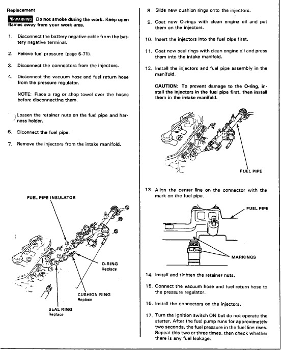

Two injectors on the throttle body?
The diagram may help for fuel injector disassembly. I don't know if they can be cleaned but it might be worth inspecting them.

yes two injectors. I have a dual-piont fuel injection system. I did not find a pic in the downloaded manual, however there is one on page 4-15 (lower right corner) of my Haynes manual: 1984 thru 1991. do you just pull them out? I removed the clip and they would not budge. nothing there to really grab on to with out the risk of damaging them other than the meter check in the book, what else would I be looking for? I once heard that injecters could be cleaned in an ultra-sonic cleaner.
