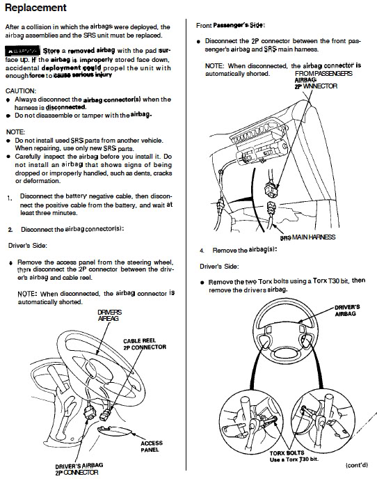

I'm an average car owner - I change my oil, had to do the work on an exhaust job (after the Cat. Converter). Right now, I'm repairing several state-mandated issues on my Civic. I failed my emissions test because of two bad O2 sensors and later got pulled over and was handed a work-order to replace my horn/airbag on the drivers side and fix a windshield crack. Anywho, I found a package on eBay of both the airbag assemblies and grabbed it up for $130 - a good deal I thought considering how hard it is to find ABs in junkers and the price shops charge for that work. I just got the steering guy in no problem but I have no clue how to replace the passenger-side dude. Anyone have any insight on this mystery? It's a '98 Civic LX.

I think the air bag can be installed by removing the glove compartment from the car (unscrew the hinges at the bottom) and working through that opening.

Thanks everyone, I got the airbag in with only a moderate level of frustration. Those diagrams helped, but for the record, the cable harness is secured behind the lower dashboard panel in front of the stick-shift (where the 9V outlet is), and that panel has to be at least partially removed to completely remove the airbag.
