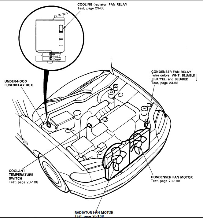

First check whether fuses 13, 33, or 35 is blown.
Engine OFF: Disconnect the connector for the 2-wire (2P) coolant temperature switch located in the thermostat housing. Get a ~4-inch piece of wire with a section of insulation removed at each end. Insert each end of the bare wire into separate terminals of the free connector (leading to the fan relay). In essence, you are completing the circuit at the free connector.
Turn the engine ON: If the radiator fan now runs, then the temperature switch is bad. Replace it. If the radiator fan does not run, then the radiator fan or fan relay may be bad. Next, supply power directly from the battery to the radiator fan. If it runs, the radiator fan relay in under-hood fuse/relay box may be bad or there is a circuit/wire problem.
Is it a good idea to replace the cooling fan relay due to age? My AC compressor fan will not turn on either (but compressor switchs on) so I'm thinking of replacing the relay on that, as well. Both relays are original and the car has almost 250k miles on it.
I don't think you need to replace good relays. As mentioned above, run power directly to the condenser fan to test whether it works.
