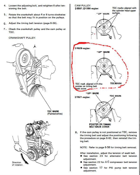

The ignition timing should be set only when the engine is fully warmed up and is idling to spec. Did the pointer (aimed like the sight on a gun) on the timing belt cover align perfectly with the red mark?
Is the CEL on now?
Was the distributor turned fully in one direction to set the timing? If you can't perfectly set the ignition timing, then check the mechanical timing of the cam and crank:

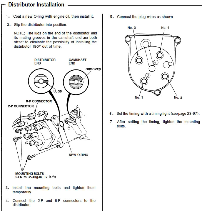

Do you have the plug wires in the correct firing order on the distributor? The cylinders are ordered 4-3-2-1 from the distributor to the timing belt.

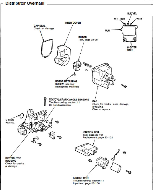

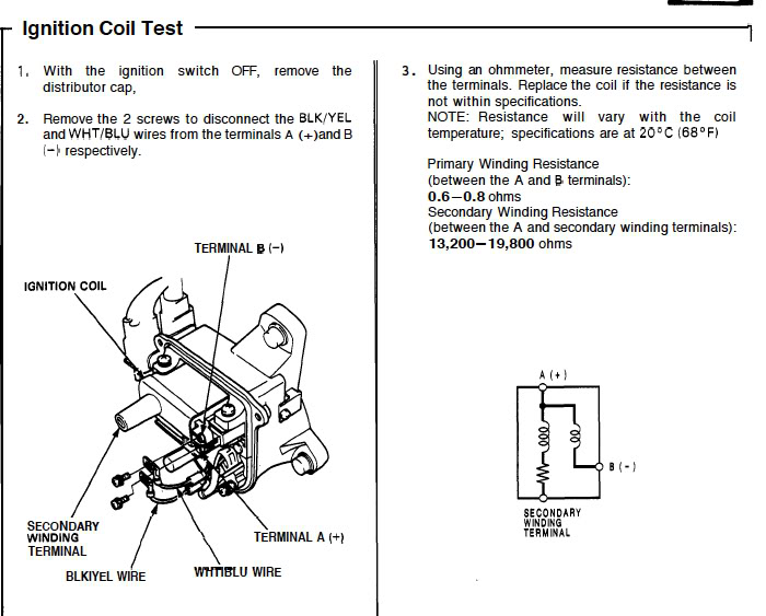

You possibly damaged the distributor getting the rotor off. Pull the plugs and the distributor cap to inspect them. You should also remove the coil and igniter unit from the distributor and have them tested at an auto parts store. You could test the coil yourself if you have a multimeter. Is the inner cover missing inside your distributor?

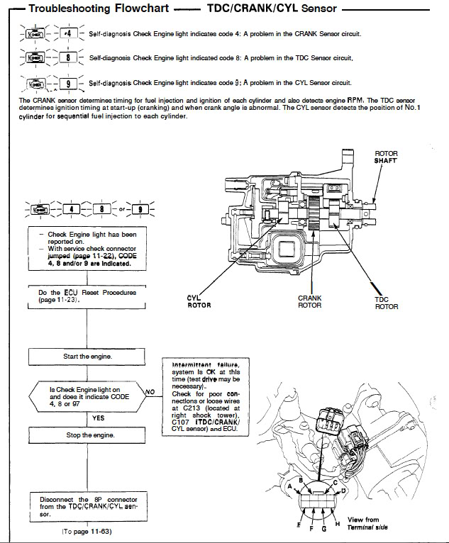

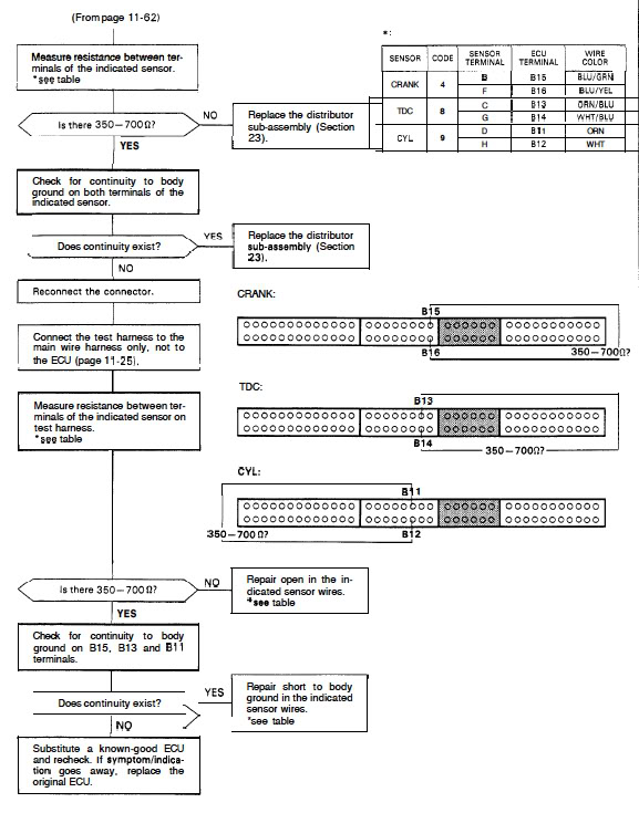

Code 9 has not returned, right? You can still test it by measuring resistance of this distributor sensor:
