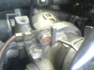

you may have bad grounds, make sure you have a ground form the battery to the frame and from the battery to the motor, and check the grounds on the thermostat housing, or a bad ignition switch.
