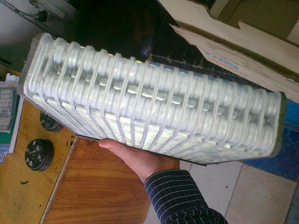

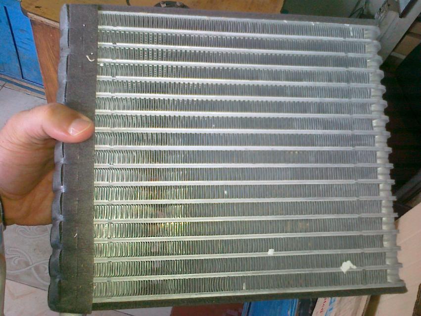

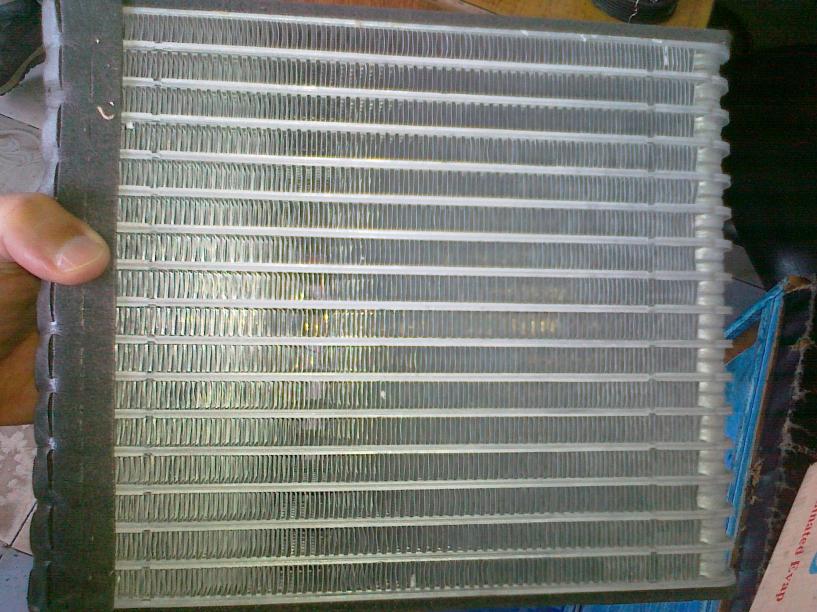

Pretty much everything so far has boiled down to the $60 evap coil. When the fins and tubes are not the right capacity, of course the air is not going to get cooled enough, neither will it do an efficient job of sucking heat and humidity quickly from the cabin. Also explains why it doesn't have to work as hard at night, though I've to wait at least 3 to 4 mins until the air is ice cold. A friend O' mine from Texas said the same. He says I need to have the OEM part installed. That's out of my range, unfortunately.

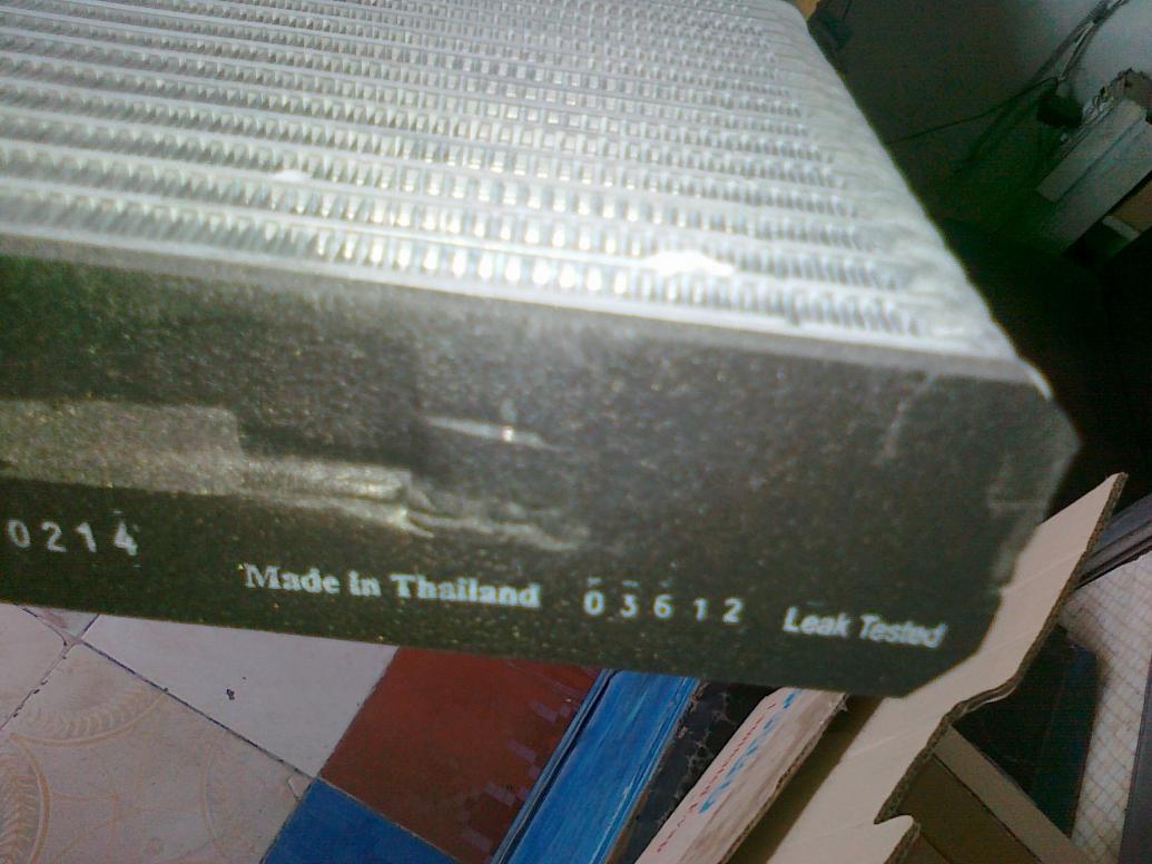

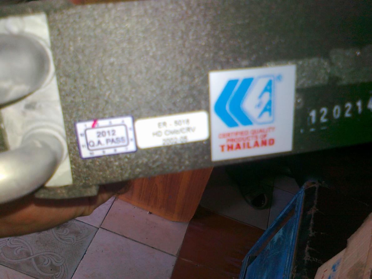

Can you please take a look at those shots of the Thai evap. core? Does it look legit to you, and that it would do the job in an 05' Civic, 4 door?
