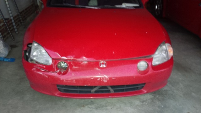

squaring up the top radiator support after a little fender bender. his tail went up my front went down and we hit at about 5 mph. it pushed the top of my radiator support down and back a bit on the passengers side.
been looking at the other threads about similar issues that were a bit worse and they replaced the front support completely.
I'm looking to pull mine back out and square it up. does anyone have any drawings with the measurements and reference points used under the hood by the body shops? Found these measurements for a mustang on another site but haven't found anything similar for the civic.
Looks like there are a ton of symmetrical holes on the top of my support that could be used for reference to the shock towers but not really sure, they seem close?
pic before the front bumper cover was pulled off.
