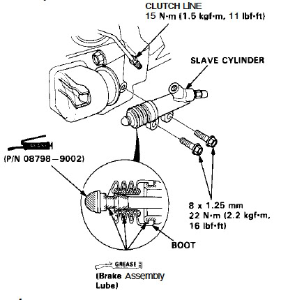

I have exactly the same annoying creaking noise when I press the clutch on my 97 DX. The noise seems to be coming from around the slave cylinder. I am thinking that the solution is more simple than a bad throw out bearing. When I get the chance, I will try applying grease at the end of the slave cylinder that contacts the release fork:

Super High Temp Urea Grease - where slave cylinder contacts release fork
Brake Grease - under slave cylinder boot
You should be able to pick up the grease at an auto parts store or even possibly Walmart.
