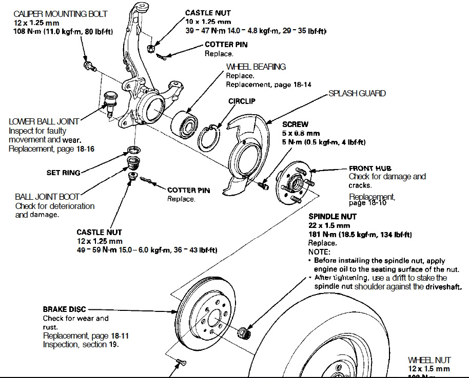

Did you possibly bend the splash guard and it's now rubbing on the wheel?

thanks guys, it was the splash guards. unfortunately a DIY project with pliers turned into a crushed hand and a big ER bill thanks to the ****ty jack that came with my car :P Your input was appreciated though.
