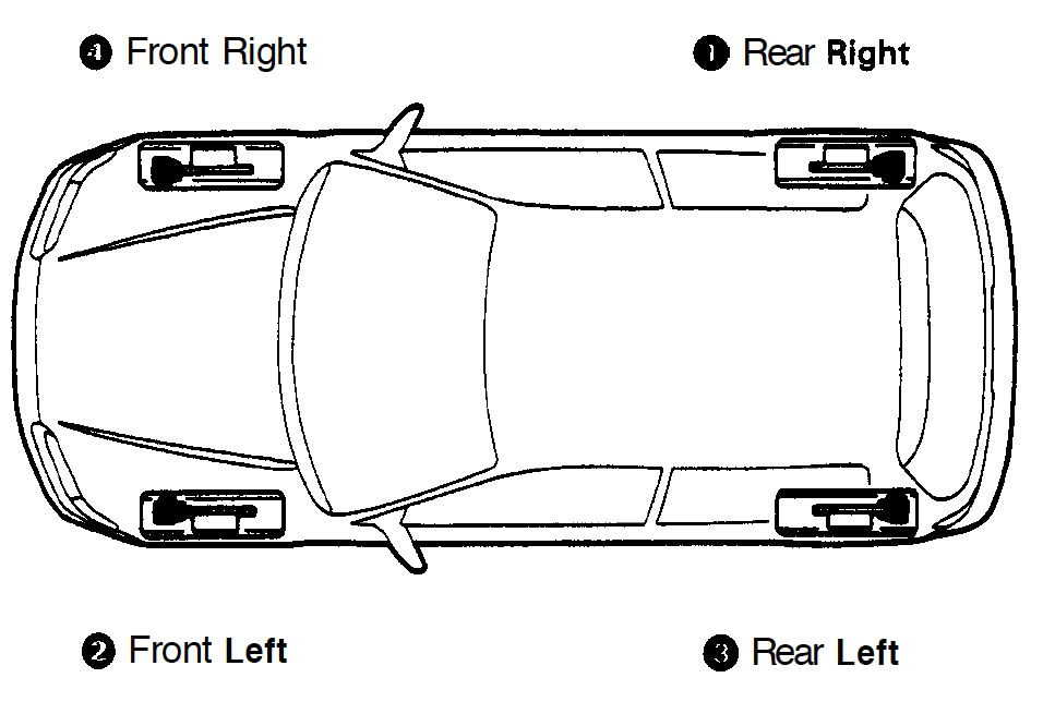

Did you bleed all four wheels in the correct order?

Old Jun 19, 2009 | 08:32 PM
liquidrider_3214's Avatar
Posts: 32
actually no i didnt, ill try that in the morning, i did passenger rear, driver rear, passenger front, then driver front. thanks man i hope this works

alright i woke my roomate up to sit in the car, and i bled the brakes, still having the same problem

If the brakes aren't fully bled, it may seem OK with the engine off but when you start it and the power brakes kick in, it will go to the floor. So you know the power brakes are working anyway.
After running completely out of fluid, it can be hard to get all the air out. A vacuum type brake bleeder may do a better job and also doesn't need a helper.
