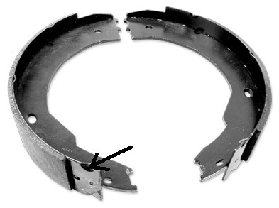

Ok the squealing sound is back..I thought I fixed it by adjusting the brake shoes down alittle..but NOPE!
I noticed on the outside rim of my rear brake shoe the black paint is scraped off...that's likely where the squealing sound is coming from & coming in contact with the drum.
The area I'm talking about is attached below.
None of my other brake shoes are like this..I tried bending that part inward..it made it worst..I even cut off a very small chunk..squeal is still there but it's a different sounding squeal now.

There should be a spring across the bottom and one across the top. The springs go into a hole in each shoe and pull the shoes together to hold them in the bracket (at the bottom) or firmly against the adjuster and wheel cylinder (at the top). Is that spring broken or missing?
