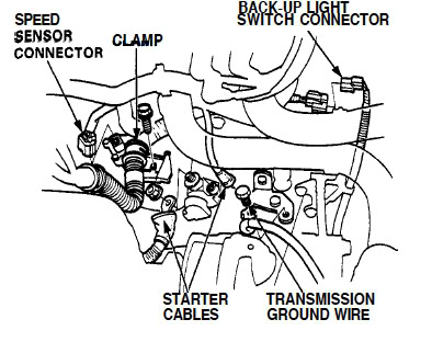

The G3 transmission ground.. wire coming off the transmission? I've never checked it before.
Old Nov 2, 2010 | 10:46 AM
Manual or auto transmission?
Manual:

Manual.
Old Nov 2, 2010 | 10:49 AM
Manual.
See my previous post.
