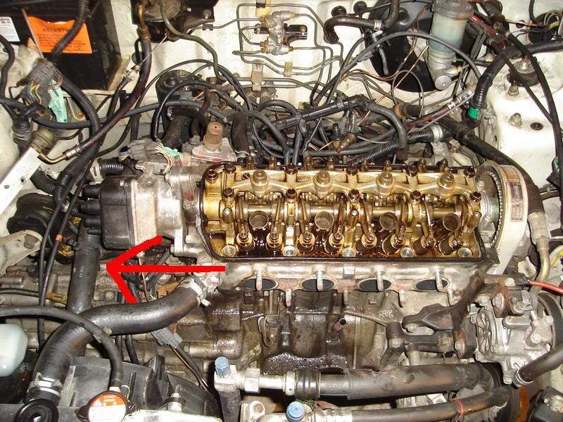

my question is very simple that i couldnt find anywhere.
i have 97 dx 4dr
where is the thermostat located.
that was it

Ive enclosed a picture of my engine bay, follow the hose I pointed at, go towards the firewall of the car........There is a housing with 2 bolts on it.....Inside that is the thermostat. Remember to drain the coolant before removing that hose, coolant will go everwhere if you dont. -Pete

thx bro.i searched almost everywhere on the net even here with no answers
i like to see pictures alonge answers.sometimes picture is more specific.
