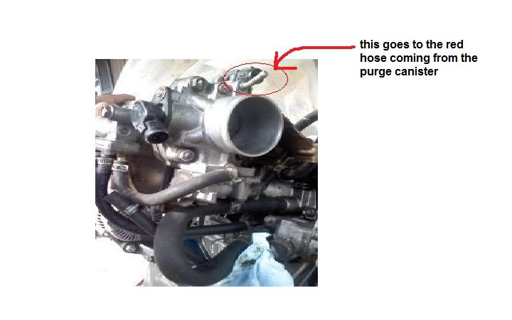

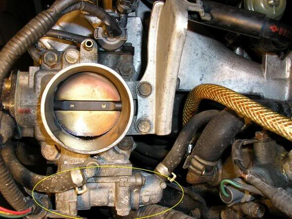

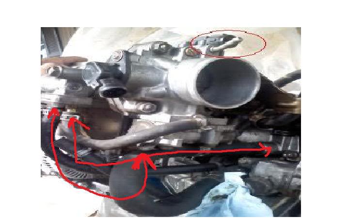

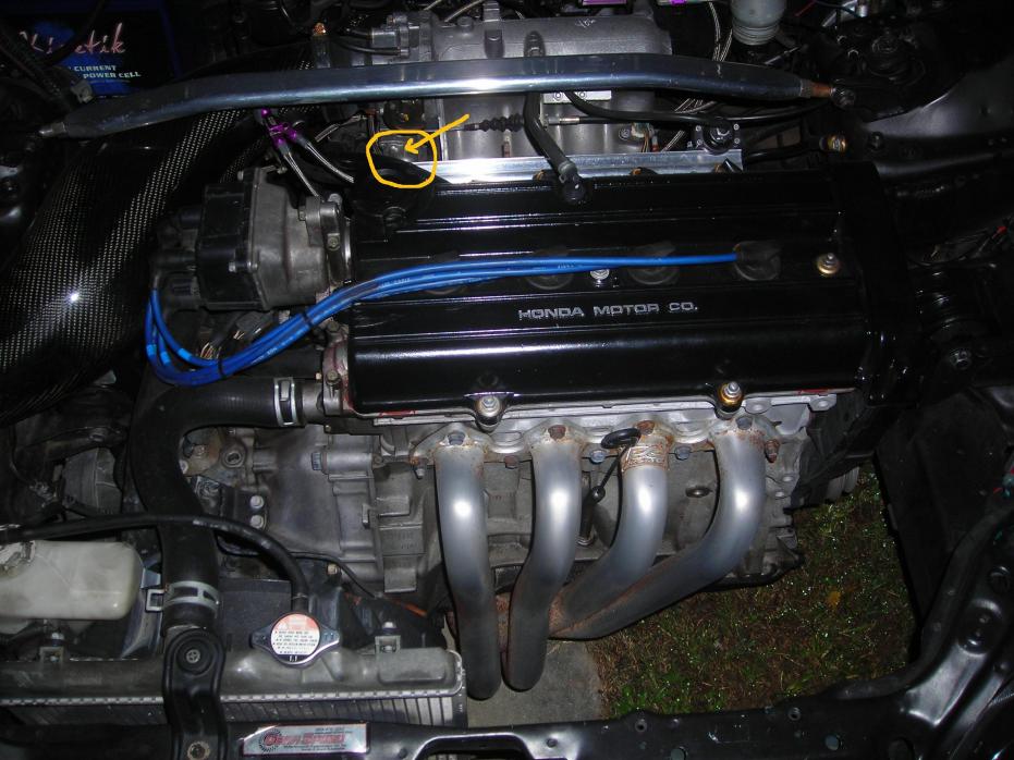

any of these pics show it???

the last pic i posted shows how to hook it up. its the fitv
