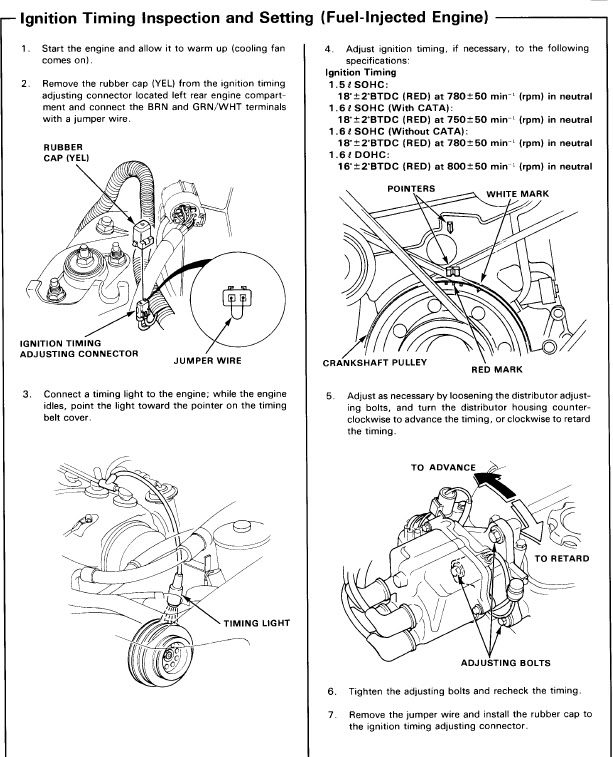

I think you originally had the mechanical timing correct and you just needed to adjust the ignition timing with a timing gun.

Yes, always check the spark timing after replacing the belt.
Double check that the marks on the crank and cam now line up as close as possible the way you have the belt on now.
