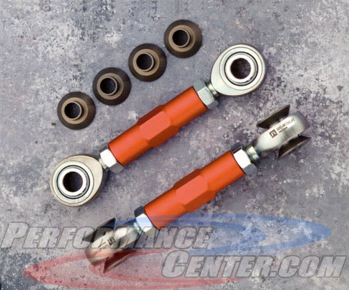

Rear - Rear Racing +/-.75-Inch Toe Adjuster
are these actualy for TOE in correction or camber adjuster....... i know it says TOE but looks kinda like a camber adjuster.... and well my camber is good! but my toe is messed up on the one side... i figure if this could give me alot more adjustment over the stock stamped piece then id go for this and be sure i have enough adjustment flexability for when i go back to the alignment shop....
just first time ive seen a so called TOE adjuster piece....

you shouldnt be able to adjust anything in the rear...since its a 6th gen, but then again the 99-00 are a little different. any who, that kinda looks like the camber...adjuster...and thats crazy how you messed up your toe angle....you had to hit something pretty hard. any way....im not even sure if you can buy an adjuster kit for the toe..you may have to buy OEM parts because to mess up the toe...i think you would have had to bend something like the knuckle or something. the only to parts on my suspension.. (6th gen 98) that can be changed beside the knuckle are the Lower control arms (cant effect camber or toe) and the upper control arm which is non adjustable, but by buying a piece thats threaded, like the thing you got in your picture, you can adjust the camber angle....

well i cannt see anything bent.... and the guy said the bolt is froze up and he didnt want to try anymore and snap the bolt on my passenger rear... but it says it will fit 92-00 civic so id think you do have a adjuster.... ill have to get a picture of the part that i THINK it replaces... its on the knuckle more towards the front of the middle and turns inwards...

and that IS a toe adjuster. it allows you to tweak your toe settings more easily than the stock adjuster. But if your bolt is seized, how do you plan to install it?

it replaces the "compensator arm" on the right
that pic is for the front...he says its for the rear...and ill go out and snap a pic of my rear suspension...no i wont cuz its 81 in the shade...too hot to go out and jack it up...but ill get one and post it...im pretty sure everything in the rear is non adjustable.... any who...addiction, the passanger side shouldnt be frozen..but its better safe than sorry, because we snaped a bolt for the LCA, so my car was on stands for a week in my buddys garage while they were sent.

but this is the thing... if the bolt is stuck, you can't install the aftermarket adjusters. And if you get the bolt UN-stuck, you don't need the aftermarket adjusters. I don't think you intend to make frequent adjustments to your rear toe settings on your daily driver.
I had the same problem last fall when I went to get an alignment. they said one of my rear toe adjusters was stuck. It wasn't off by a whole lot so I didn't worry about it right then. But then over the winter when I went to do my rear disc brake swap, we couldn't get either of them out (you have to take out that bolt to swap the trailing arms). we had to set them on fire to get them out. (if you do this then I guess you WILL have to go aftermarket, as the stock compensator arm will have no bushing left in it anymore.)
You can't see this, but the bolt doesn't just go into a threaded hole. The "nut" that it threads into basically has a big flange on it, and when loosened, it moves back and forth like a sliding door. you loosen the bolt, slide it left or right to get the correct angle, and when you tighten it, it clamps down on the sliders. You can't see this part because it's in that little sealed part of the chassis, with just a little hole in the bottom. You NEED to get that bolt out without damaging it.
