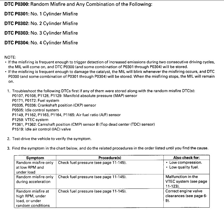

It is rare for the ECU to go bad. I think you should take your car to a new mechanic who has extensive experience working on Hondas.
Blinking of the CEL while driving indicates the occurrence of misfiring so severe that the catalytic converter can be damaged (see diagram below) -- so you don't want to run the engine very long under these conditions.
Take your car to AutoZone where they will read the CEL trouble codes free of charge. Post the CEL codes to get additional feedback.
