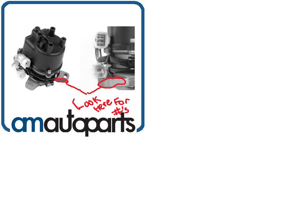

there is a stamp, on the side of where the bolts go in the distributor to bolt it to the head.
any 88-91 civic dpfi will work. it should say TD-01U
