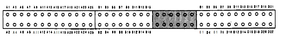

So in order to check the ground on the thermo housing I should test from that end to the end where it plugs into the ECU right? ..... Now for a tricky part do you have one of those magical pictures that tell what each wire on the harness the plugs into the ECU are? lol
Yes. The info below is what you need:
ECU connector pins
The ECU ground wires pin here:
A23 (BLK wire)
A24 (BLK wire)
A26 (BLK/RED wire)
B2 (BRN/BLK wire)
For all pins in ECU connectors A and B, check continuity to ground. If any lack continuity to ground, then you've found the problem.

I will finish this test this weekend, if harness tests out then I maybe looking at a second bad ECU? Or hard telling lol...... Thanks for the illistrations I really appreciate them!!!
