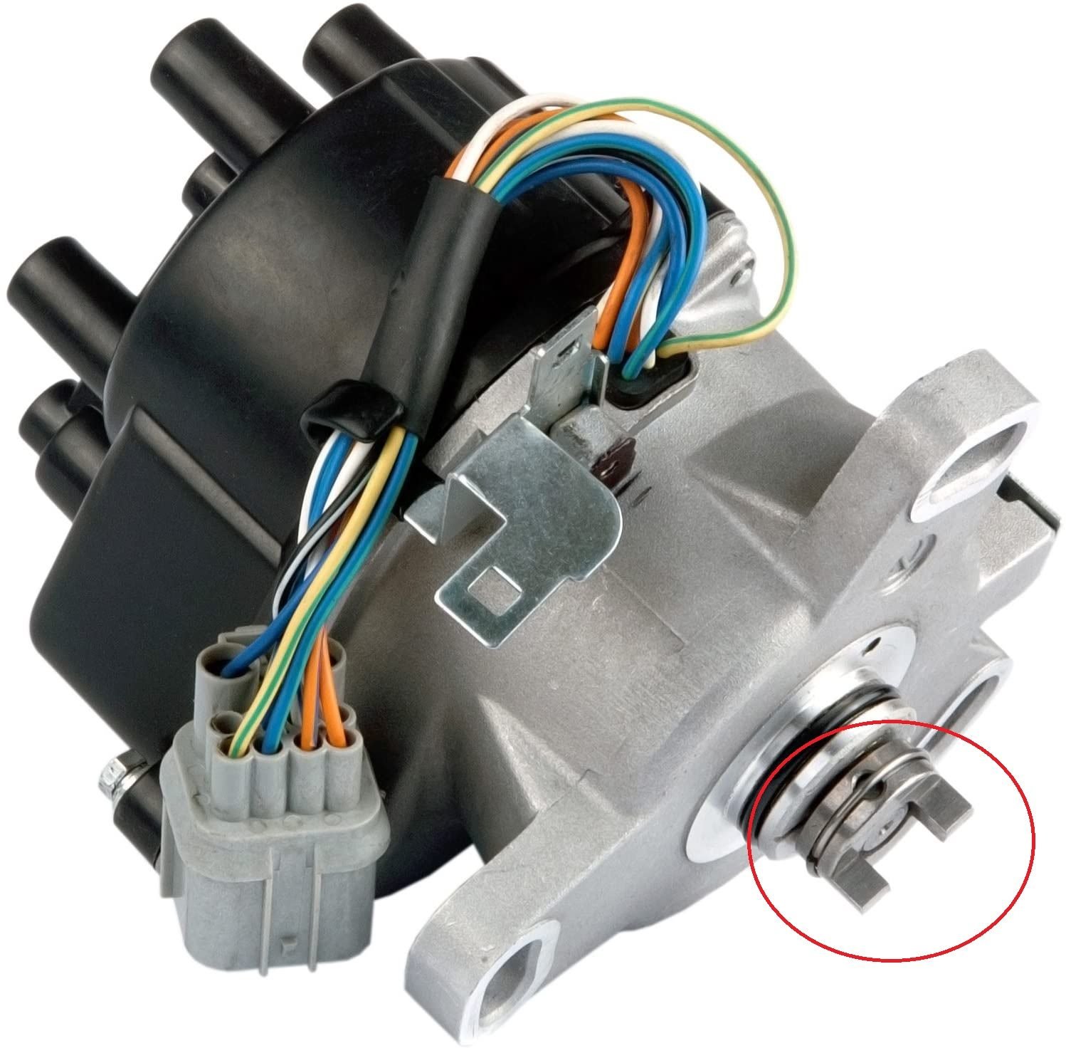

Try turning the distributor pickup 180*. It's possible to install it incorrectly that way after removal.

Just so we're on the same page, why would they break off? I'm talking about the part circled in red. It's completely symmetrical on every civic of that gen that I worked on and the reason why it's possible to put that piece in incorrectly.
